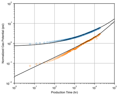

I need to format the tick mark label for a log axis to show the number with 10 as base and the power as superscript (10²)
Please let me know if you know how to do this.
The example below shows what I want to achieve.
Thanks.

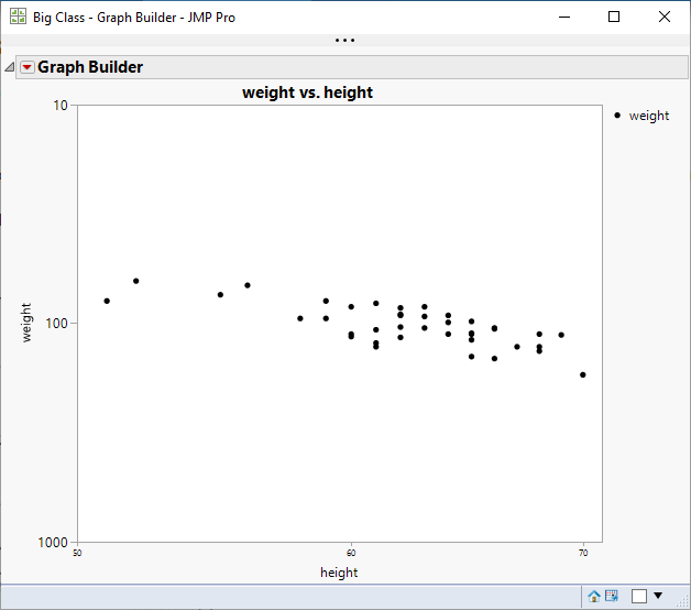

Here is the initial plot using default log scale:

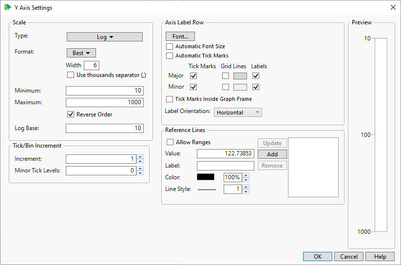

Right-click or double click the axis (the Y axis in my example) to open the axis settings dialog.
Use the settings on the left side to use the log type of axis, the minimum and maximum to start on a power of ten, the log base of 10, and the number of tick marks.

What I am referring is to the format of the tick label specifically.
In the example you provided, the format for the tick label of 1000 is "1000." If I switch to scientific format it is going to be "1.0e+3." Following this example, I want the label to be displayed simply as "10³ ."
Is there some type of custom format that would show this?
