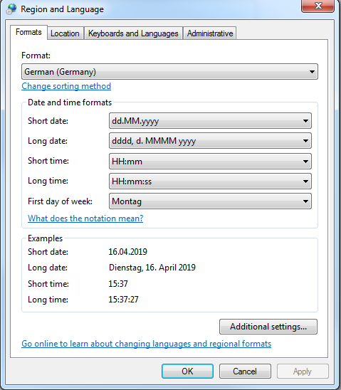

  Yes, in fact the column is set to "date" with a German style d.m.y. format. Please check a previous post in this thread where I include a screen shot of the Excel column property window and the setting. Even my system setting is like that, see below.
Thanks!,
DS
