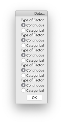

It appears to be showing up for me at the top of the window, but just the once as you have it programmed. If you want one textbox for each column selection, you could do another append in each iteration of your for() loop:
Names Default To Here( 1 );
dt = Open("Example1.jmp");
number = N Cols( dt );
FactorType = {"Continuous", "Categorical"};
New Window( "Data Entry",
	<<Modal,
	<<return results,
	type = V List Box(),
	For( i = 1, i <= number, i++,
		type << Append( Text Box( "Type of Factor" ) );
		type << Append( Radio Box( FactorType, Max Selected( 1 ) ) );
