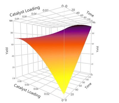

Font colour changes when spinning a surface plot
I've produced a surface plot using a predicted formula from a definitive screening design.
I'd like to present my plot in a presentation with the plot rotating. To do so I followed this thread: https://community.jmp.com/t5/Discussions/Spinning-a-Scatterplot-3D/td-p/6510
The advice here was originally for a scatter plot, however I got it working using the same line of code:
Set Spin( 0.01, 0, 0.01, 0 )

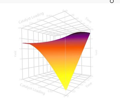

The spinning works fine, however when the plot is spinning the font colours change from black to a feint grey, making them more difficult to read:
Whilst spinningWhilst spinningWhilst stationaryWhilst stationary
Does anyone know what's causing this/if there's anything I can do to fix the problem? Or perhaps a different way to make the surface plot spin that doesn't result in this issue?

I get the same behaviour when I use Set Spin(). But not when I manually rotate the plot using click-and-drag.
I am not sure what causes this or if there is a way to fix it. You might want to contact tech support (support@jmp.com). I have pasted an example script, below, that demonstrates the issue you are talking about using Tiretread example data.

It dims on purpose to make the text less distracting. The labeled axes are already switching about to stay out of the way of the graph and were hard to watch when solid black. I'm unaware of any way to disable the feature. To extend Phil's suggestion, you can script the Frame3D <<setRotation method and capture images. @Anonymous

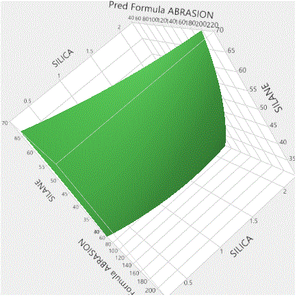

oscillating 3D surfaceoscillating 3D surface
I used gifsicle to make the animated gif; there are many ways to turn the sequence of images into an animated gif or video.
