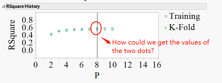

        Hi, I have a problem when doing k-fold cross-validation with stepwise regression: I want to run the k-fold cross-validation with stepwise regression for 100 times using same dataset and save the R squares for both the training and the validation sets. The results table of JMP include two columns, “RSquare” and “RSquare K-Fold”. Although I can get different “RSquare K-Fold”, it seems that every time the “RSquares” are the same. That means maybe the “RSquare” is not the R square for the training set and the “RSquare K-Fold” is not the R square for the validation set.
        So, how could I get the two values (i.e., R squares for the training and the validation set)? How could I change my script to get these values?
        I found that in the option of the "Plot R square history" we can get a graph of the R squares of the training and validation sets. Then how can I get the value? It seems that it only gives a graph (see the Figure).

The column "RSquare K-Fold" was added to the History report for additional perspective when considering the candidate models. The other columns are the same as without this stopping rule. That is, they are result of fitting all the rows. You can observe the change in the R square overall and for the hold-out data look for signs of over-fitting.
I do not know of a way to obtain the R square for the model fit with only the training sets in the Stepwise platform.
The plot that you refer to plots the R square value from the RSquare column. You can see that if you add a reference line to the vertical axis for the maximum R square value in the History.
They are the same.
