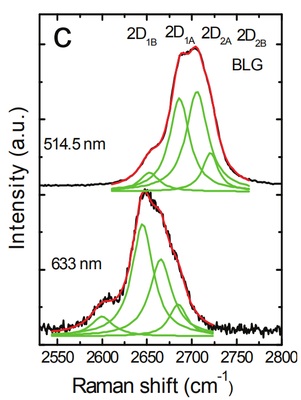

I would like to get multiple normal mixture fitting to my data similar to what is presented here
arXiv:1306.5856 Electron_1-1617139876211.pngElectron_1-1617139876211.png
Any thought on how this can done in JMP or JSL? Can I set a lower/upper limit on each peak locations in exchange for, likely, worse fits?

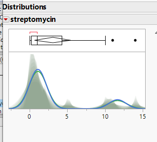

txnelson
Re: Fitting multiple normal mixture to data
There is a similar capability in the Distribution Platform if you use a Shadowgram option and then you can place 2 and 3 mixture distributions on the Shadowgram
Jim
