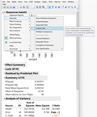

not sure about the Fit Y by X platform. why not use the Fit model Platform instead? there, there are the "custom test" option. is that what you are looking for?

The custom test only takes particular combinations of slope and intercept as parameters and calculates the p-value for the combo. In principle, this comes close but the intercept value doesn't come out of the theoretical expectation, so I don't have an estimate for it.
