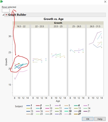

Hi,
I want to display number of selected rows in the modal window. Highlighting rows in the graph builder plot and displaying number of selected rows in the text edit box. Are there any options?
Names Default To Here( 1 );
// Open Data Table
dt = Open( "$SAMPLE_DATA/Growth Measurements.jmp", invisible );
New window("", Modal,
tb = Textbox("Rows selected"), text editbox(""),
Vlistbox(
gb = dt << Graph Builder(
	Size( 522, 452 ),
	Show Control Panel( 0 ),
	Legend Position( "Bottom" ),
	Graph Spacing( 8 ),
	Variables( X( :Age ), Y( :Growth ),Group X( :Growth ), Overlay( :Subject ) ),
	Elements( Line( X, Y, Legend( 13 ) ) )

// Open Data Table
f = Function( {a}, teb<<settext(char(nitems(dt<<getselectedrows)) ));
rs = dt << make row state handler( f );
New window("", Modal, <<onclose(rs=0;1),
tb = Textbox("Rows selected"),teb= text editbox(""),
Vlistbox(
	Size( 522, 452 ),
	Graph Spacing( 8 ),
The onclose script clears the handler when the window is closed so it won't make log messages about the missing TextEditBox, AND it returns 1, which allows the window to close.

I just want to be sure that you are aware that the row state status is displayed automatically in the Rows panel at the lower left of the Data Table. It isn't clear to me that you want a custom status.
Jackie_
Level VII
Re: Display number of selected rows in the new window
Because I am creating a UI with modal window and the open data table in invisible to the user
