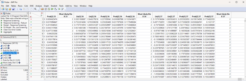

I did not find any overwriting of the data.

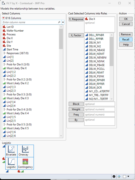

Using the JMP Sample data table, called Probe.jmp I ran a Fit Y by X, specifying DieX as the Y, Response and 37 numeric columns as the X, Factors
Holding the CNTL key down, I clicked on the red triangle and selected   Save Probability Formula
The data table started out with 394 columns, and ended up with 616.
Each of the 37 parameters created 6 columns,. Each set of columns are unique and based upon a different Y response for each of them.
What did I do that was differant from what you did?
Jim

What I am doing is different on two fronts:
a- mine is multinomial (have 5 classes) and likely yours is binary - what that should not matter
b- mine is By a group
I tested w/ 2 parameters and no "By" group ... it worked as you did show
I then tested w/ 2 parameters and "By" group .. it did not work. In the end result, there was only one set of probability that incorporated "By" correctly into the formula (instead of creating one formula for each of the "By" options) but it failed because it skipped first parameter and only did this for the second one.
