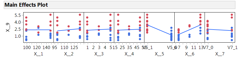

1. Fit Definitive Screening identifies X__3 as significant and not X__2. I do know that if I use Fit Model to do this that X__2's parameter estimate is much smaller than X__3's, so there is a smaller t-ratio and so X__2 is not significant. That is fine, but seems to contradict the Main Effects Plot shown here:
2. Based on the Prediction Profiler, the parameter estimate on X__7 has a different sign than what we see in the main effects plot.

There are a number of issues here.
In the main effects plot the line of fit that is shown is the result of the simple linear regression of y on each individual x. If there are no categorical factors, then the slopes for all the factors would be the same whether you did a linear regression or a multiple regression because all the main effects are orthogonal. You have two categorical factors so there are small correlations between these factors and all the others.
X3 is correlated with the categorical factors X5 and X7 so that the main effects plot showing the fit of X3 on Y with nothing else in the model is has a coefficient of 0.08 due to aliasing from X5 and X7. Its coefficient in the main effects model, by contrast is 0.22.
X2 is also correlated with X5 and X7. Its coefficient in the main effects plot is 0.157, whereas its coefficient in the main effects model is 0.014. In this case the simple slope of X2 versus Y looks steeper again due to aliasing by X5 and X7.
I should point out that your data table is not a DSD. There are correlation between main effects and two-factor interactions. This is because a few of the entries in X5 and X7 got switched between foldover pairs.

So essentially we should ignore the main effects plot if we are running a "DSD" with categorical factors? The "Fit Definitive Screening" reduced model is giving the best estimates we can get, short of collecting more data to break the aliasing?

If the categorical factors are not active, then the main effects plot will be useful. However, if the categorical factors have large effects, then you should believe the profiler rather than the main effects plot.
It is too late to change this undesirable behavior for JMP 14 but I hope to plot the line using the coefficient from the multiple regression of the main effects in JMP 14.1.
Re: Fit Definitive Screening: does Main Effects Plot disagree with model Parameter Estimates
I can confirm that the behavior Bradley mentions has been addressed in JMP 14.1, which will be available very soon.
