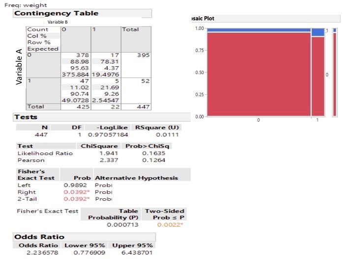

I am a regular user of JMP, but without experience in scripting. I have used Fischer's exact test on my analysis, and am getting the results as posted. I have 2 questions:
1. Why do I get 2 difference exact tests and p-values? Which is the one to use?
2. In the odds ratio, the confidence interval does not match the p-value (which is <0.05). I am guessing it has something to do with the way with the CIs are calculated. Can you advise the best way to calculate the exact CI here? I am not experiencing this issue with other exact analyses used in the same dataset
Thanks

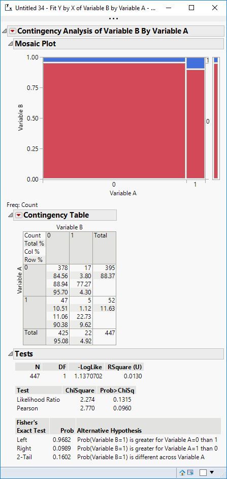

  1. You do not understand the exact test for a 2x2 contingency table. It is possible to use it three ways. The Alternative Hypothesis explains each way and allows you to decide which of the three tests is appropriate for your decision.
  2. The odds ratio confidence interval does match the tests. The p-values are greater than alpha = 0.05 and the 95% confidence interval for the odds ratio includes 1.
I have no idea what you might have done wrong or differently with this analysis compared to other analyses with the same data set. What other analysis is there?
I do not get the same result for the analysis of the same data. See my result:

Hi Mark,
It looks like the first analysis used the Weight for the Frequency while you used the Counts; would that be a possible source of different behavior?

Thanks for your replies. I also think the 'weight' (which is a sampling weight for the study design) may have changed things, as @Thierry_S suggests. If I only use the 'counts' from this 2*2 table in the 'frequency' section of the contingency platform, I am getting the same results as you, @Mark_Bailey . As for the alternative hypothesis, I would need to use the one that corresponds with two-tailed values only
