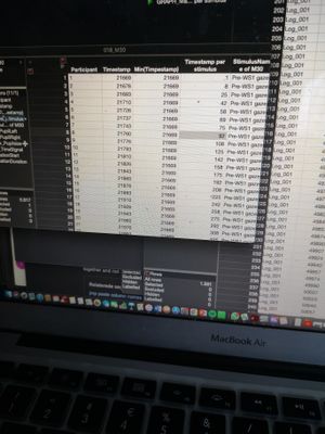

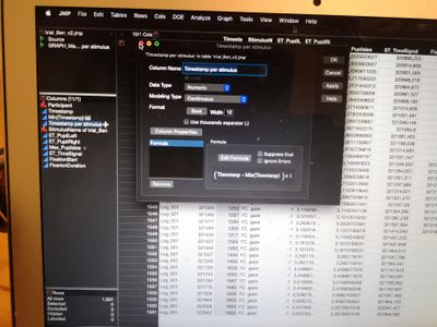

Hi guys,
For my master thesis, i am working on pupil diamanter measurement and my supervisor told me to install JMP Pro and she took one of my trial participants and cleaned up the raw data.
However, she wouldn't be able to meet me for some time and asked me to clean up the data like she has. The issue is that I never tried the program before. Now some of it makes sense with regards to deleting the columns, but for instance the blue things she has added, I don't know how she has done it, so perhaps anyone can help me, so i can start moving into the actual statistical analysis.
The first picture is the raw data, and the second part is the cleaned up version.
I can also send the two files, if need be.

In particular, read about modeling types and formulas. It looks like you are already using them. Assigning the correct modeling type (continuous, ordinal, nominal) to a column will help when you choose an analysis platform. Making new columns as a formula of existing columns can simplify your work.
There is also a hidden column, with a mask.There is also a hidden column, with a mask.

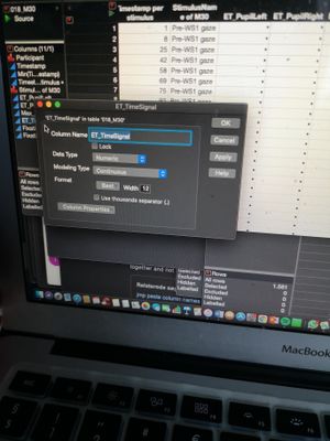

I can say i found out how to make them blue (numerical - continuous)
However, when I do that for some values, it just turns it into a black dot.
It strangely doesn't do it in the timestamp values but for the others it do.
I then try to change the columns back to normal, but then the numbers previously just disappear?

JMP converts cells to missing values (the dots you are seeing), when the values in the cell can not be converted to a valid number.

Okay, So here are the files:
The trial Ben file is the "cleaned-up" data, which is what my master supervisor wants me to do.
The M30 file is my attempt of doing, what she did:

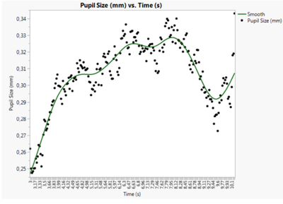

Other than that, she also made GRAPH on the top left corner, so if anyone could tell me how it is done, I would be appreciative.
