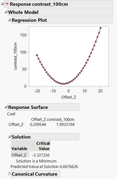

Or, another approach is to use Fit Model, use the Response Surface macro so that JMP sets the response surface attribute. Then you will get a response surface output that solves for the critical values.
I had JMP create this script with some data that I made up.

Here is the part of the output that finds the critical value.

Thank you for reply.
I tested the script and found that this is exactly what I was looking for.
(Even though I didn't understand the whole code )
but I found that the Offset_Z value which is calculated by response surface is slightly different from my manual calculation (by differential)
the difference was under 0.0003 so it was no big deal
Thank you again for your help
