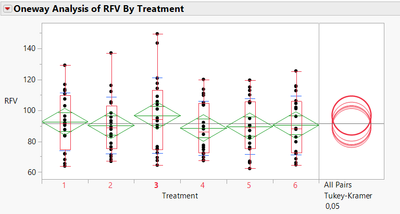

If I understand well the question, you are interested into knowing if you can find significant statistical differences between Treatments. You can do this testing easily with the platform "Fit Y by X", by specifying the Treatments as your X and RFV as your Y variable.

In your case, you have a slight deviation from normal distribution, and other assumptions seem to be respected, so you can use a parametric test assuming equal variance and properly adjusted for multiple comparison (to avoid Type I error), like Tukey-Kramer test :
Indeed, no treatment seems to be statistically significant from the others.

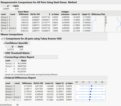

Just for information I did it with the informations you provided (by hiding and excluding cuts 4 and 5 and grouping Treatments 1, 3 and 5 in Group 2, Treatment 6 is Group 3 and the rest is unchanged), and I can't see any differences in the outcomes of the tests :
