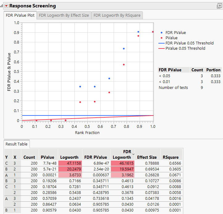

I think the Anayze > Screening > Response Screening tool might be what you are looking for. It allows you to put in many Xs and many Ys, then gives a sortable table and graphs (although the table has PValues rather than F Ratios). Sample data table attached.

Thank you Jed, it is exactly what I looked for!
