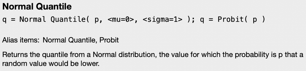

There are many distribution functions available to column formulae and to scripts. See Help > Scripting Index, select Functions at the top left and then select either Probability or Discrete Probability, depending on the nature of your distribution. For example, if I am using a normal distribution to model my data, then I would select Probability and then select the Normal Quantile function for the desired result:

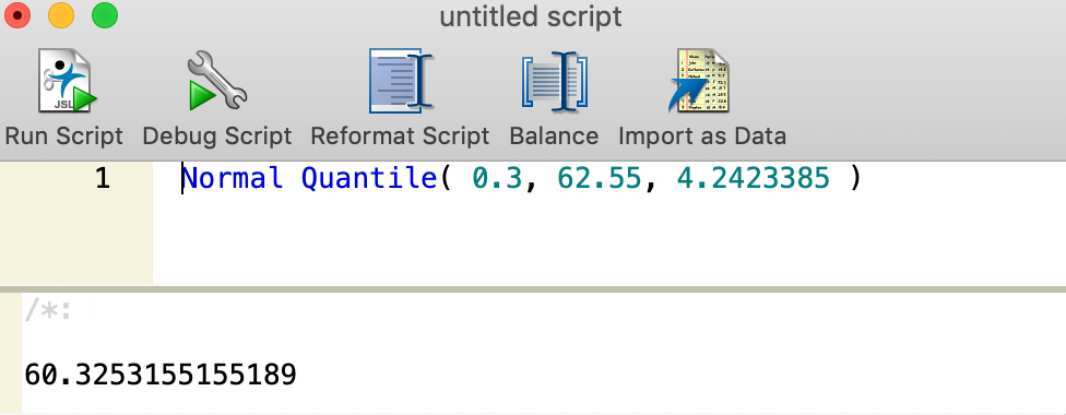

I can now use the parameter estimates with the Normal Quantile() function to determine the probability I want:
In this case, I used the function in a script editor and obtained the result in the embedded log.
