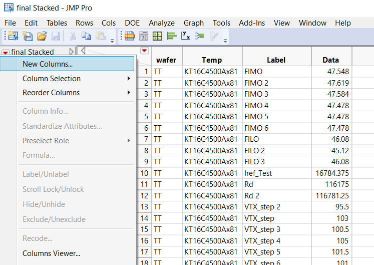

What needs to be done is to create a new column in your data table, and apply a formula to the column.

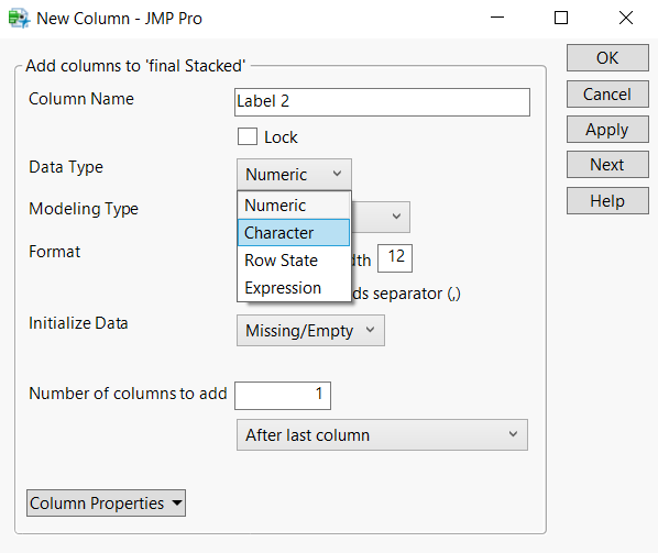

1. Open the stacked data table and click on the red triangle in the column area above the row state column.  Select "New Column"

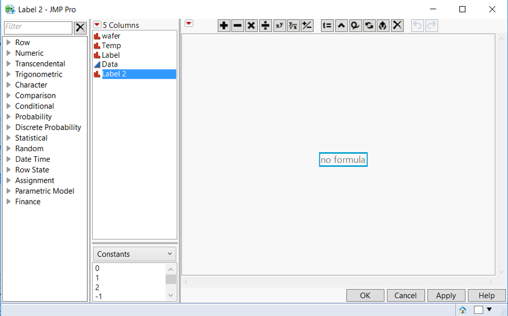

2. The Column Info window will open.  Change the name of the new column to whatever you want(I chose "Label 2").  Also change the Modeling Type to "Character"

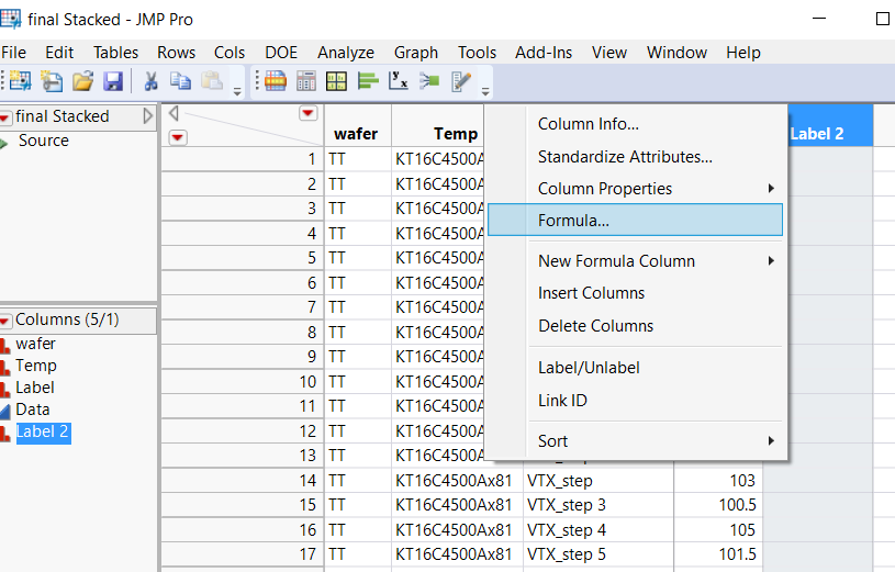

3. Click on OK and then Right Click on the header area of the new column and select "Formula"

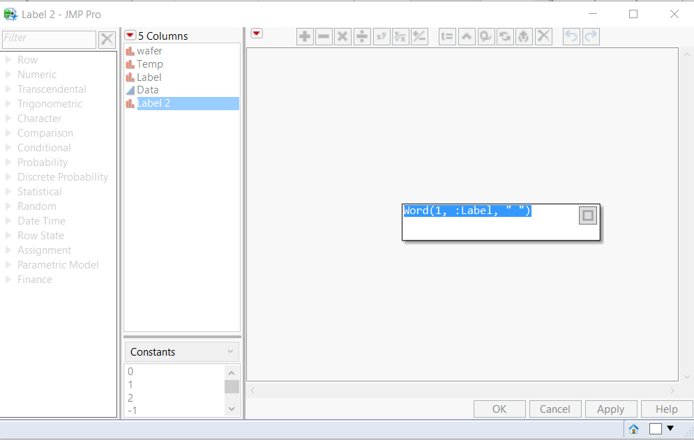

4. In the formula editor, double click on the box titled "No Formula"
5. Rather than doing the point and click formula building that we could do, with this simple formula, we just need to type it into the box
6. Once the typing is done, just click on OK or Apply and the formula will generate the new values
You can now use this new column in your Tabulate Platform

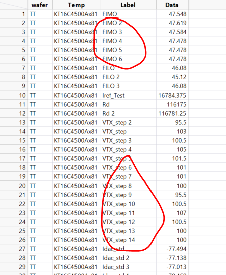

Super.. It worked half way.. I have multiple parameters... Av1, Av2.... and FIMO, FIMO2, ....which needs to be seperated as well. The current script stack everything but doen't decode label to original names

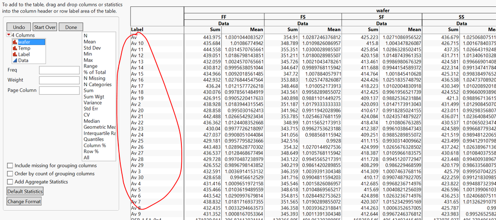

pankajet
Level I
Re: Find Min and Max from multiple columns ( Same name of colums)
You didn't get me. My problem label still has A, A10, A11, A12, ... I want min and max from all Av.. A10....
Pls help.
txnelson
Just don't drag the column called Label to the Tabulate Platform.  Just drag the column called Data.  Dragging the Label column is forcing the agragation.

pankajet
Level I
Sorry, I didn't get. Pls show me. I have attahced stackd file. You will see many lables Av, A10, .... I want min and max from Av.xx lable. Similarity from all other labels
txnelson

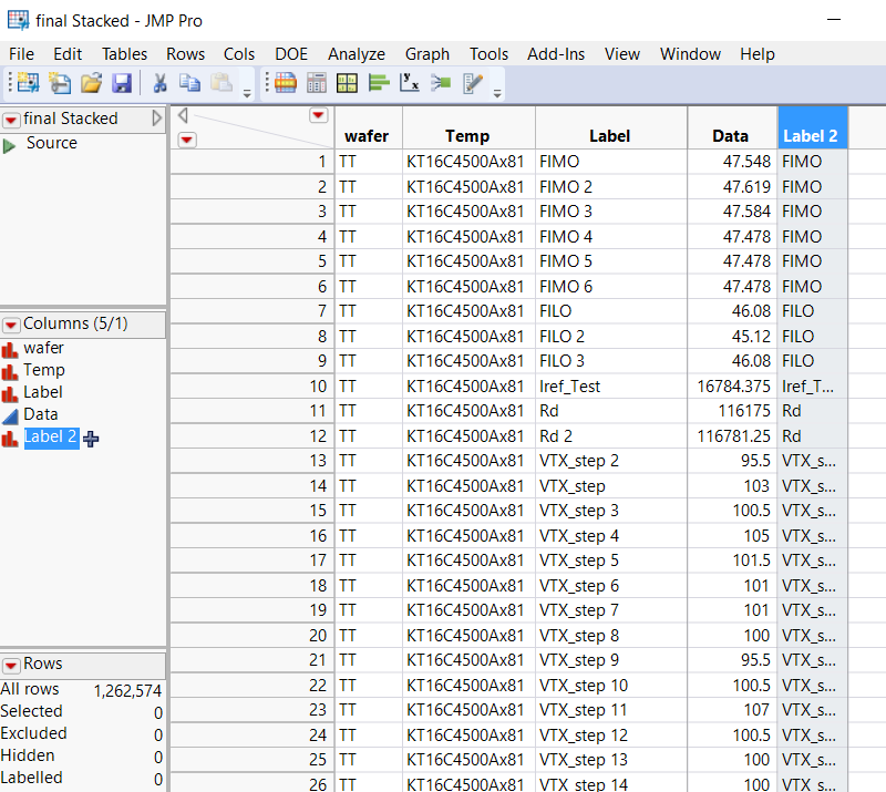

Is this what you are looking for?
If it is, all I did was to add a new column to your stacked data table, calling it "New Label" and specifying a formula for the column as:
     Word(1, :Label, " ")
The interpretation of the formula is to look at the "Label" column, and take the first Word from that column, where the delimiter is based upon blanks, " "
Jim
