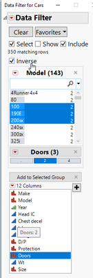

you can open a "global" data filter:
select the strange entries and then use the inverse option to show/include just the remaining rows:

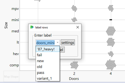

If the strange cars show up in a combination of properties, like you say:
car from 2020 with 2506000 milage
then you can plot the data, select the strange data points, and then label the selected rows
e.g. via Rows/Row Selection /Name Selection in Column.
Alternative - with more options:  the want tool from  QuickSelect Toolbar
After labelling the outliers, you can either use the labels in Graph Builder to investigate further on the details - or use the label column to remove the labelled entries from the analysis:
"???" means: no label
