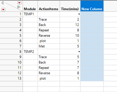

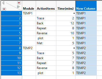

I want to assign a value to each row within a category defined in another column using JSL. For example, Module is the Category column and I want to assign this to All rows in within that category in the New column.
Unfortunately, in my case there are thousands of Modules in the module column, so doing it manually is not an option. I believe I will have to use for & if loop to fill the New Column with Module value

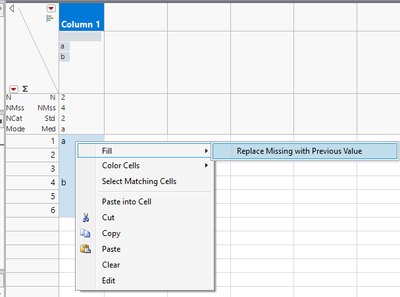

It is few button presses to fill them in by replacing with previous value. It isn't automated and if you don't need it automated, it should work fine. Other excellent options if the formula Jim has provided you with.
-Jarmo
