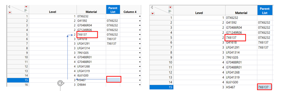

Hi
I have the following problem:

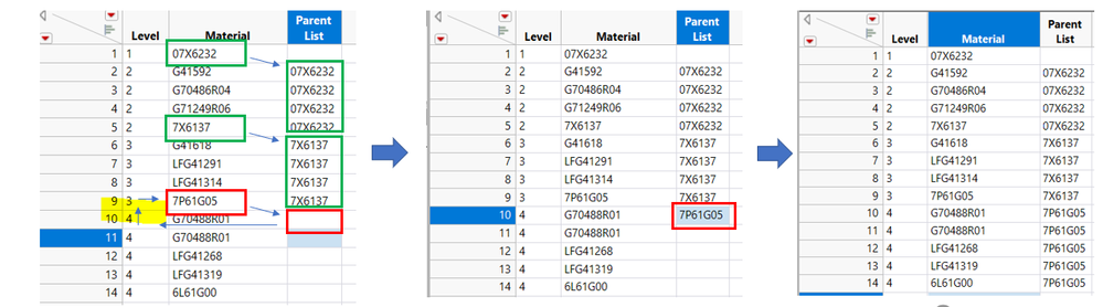

I want to fill cells via a formula or script in Column "Parent List" absed on next n-1 value in column Level:
Fill emty cell (Column „Parent List“, Row 10):
•In row with emty cell go to Level column containing  value „4“
•Calculate n-1 („3“)
•Find next row above that contains value n-1 (3), which is row No 9. Copy character (7P61G05) of Material column into emty cell (Parten List, Row 10):
Fill all emty cells accordingly.
Additionally there might occur the following sepcial case:
Numbering goes down: still select row  with n-1 value in cell
i hope anyone can solve that! Thanks you in advance,
Matthias

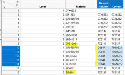

Hello Jed,
This is fantastic! Thank you so much for the great support! There is a small buck still, maybe you can resolve that too?
The script seems to look for the n-1 number further downwards in the Level Column while it should look for the last n-1, in this case Level „3“, that is before the cell to be filled! So it took the wrong characters in cells of row 10 to 14.I created the column „Correct“ were you can see the correct filled cell:
The script uses characters "D9844" from next upcoming Level 3 instead of "7P61G05" from last Level 3 before the respective row.
I will add the jmp table.
Thank you in advance and best regards,
Matthias
