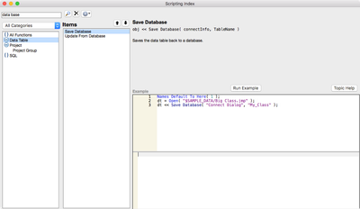

Jeff_Perkinson
Re: File > Database > Save Table - JMP13 scripting help
I think you're looking for the Save Database() message.
You can find it in Help -> Scripting Index.
-Jeff
TonyRivers
Level II
this is the format that I have been using in JMP9 & JMP11 but does not seem to work in JMP13.
dt<<Save Database("connectInfo", "TableName")
I get the following in the Log file but no actions happen n the SQL dB
Scriptable[]
