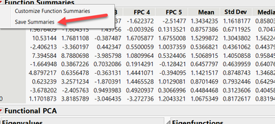

I would like to save the FPCA summaries automatically using JSL.
It seems I need to script the actions by clicking on the menu options.
So far, I can create the model with the using this script FPCA

Re: FPCA summaries via JSL
Try adding the "Save Summaries" command inside the Direct Functional PCA call. I hope this helps!
Open( "$SAMPLE_DATA/Functional Data/Fermentation Process.jmp" );
Functional Data Explorer(
	Y( :Ethanol ),
	X( :Time ),
	ID( :BatchID ),
	Data Processing( Align 0 to 1 ),
	Direct Functional PCA(Save Summaries)

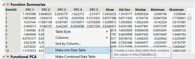

If you mean these Function Summaries here:
Make into data table:

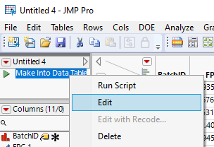

Edit table script:

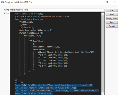

Check script and copy paste part you are interested in:
Then editing that script should get you to more robust solution.

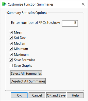

If you save summaries instead of making a table, you also keep the formulas.
FN
FN
Level VI
Running the generated script will stop and ask you for some options.
Can you automate accepting the options as well?
They all work except "Save formulas"
	Y( :Ethanol ),
	X( :Time ),
	ID( :BatchID ),
