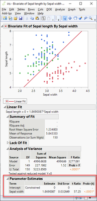

If you are just trying to find the coefficients while working interactively you can look in the 'Parameter Estimates' table inside the Bivariate fit platform.  If you want to pull this out with a script, there are a few options, one is to turn that Parameter Estimates table into a data table and get it from there:

dtEstimates = Report( bv )[Outline Box( "Bivariate Fit of Sepal length By Sepal width" )][
Outline Box( "Linear Fit" )][Outline Box( "Parameter Estimates" )][Table Box( 1 )]
 << Make Into Data Table;
// Pull estimate out of data table
dtEstimates:Estimate[dtEstimates << Get Rows Where(:Term == "Sepal width")][1];

  One (of many) ways you can do this is after performing the fit, the very bottom table in the report, Parameter Estimates, you can right click in the table and select Make Into Data Table. The Column called Estimate will contain the value of the intercept (0) and slope.
