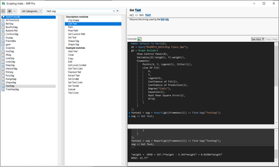

3. Checked Scripting Index for Text Seg and found one way to get the value
-Jarmo
