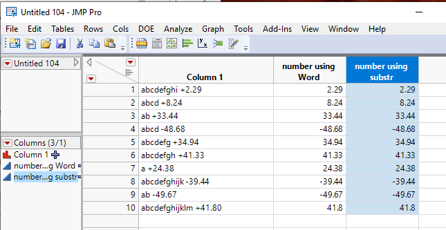

Check out the Word() function.  Given the examples you gave, one could simply look for the the 2nd word in the string, based upon finding a blank
     Word(2, <your string column>, " " )
or
You can Contains() to find a "+" or "-" and from there, substr() the string to get the numeric value
Attached is the below data table
