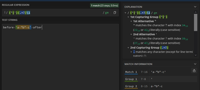

One thing that might not be obvious: the back reference can also be used in the pattern. This could be useful for making sure a leading and trailing quotation mark or apostrophe are used consistently:
Write( Regex(
	"before 'a \!"b\!" c' after", // before 'a "b" c' after
	"(\!"|')(.*?)\1", // ("|')(.*?)\1
	"\2"
a "b" c
(The \!" escape puts a quotation mark inside the strings; the comment shows the text of the string.) In this example, \1 group can match either " or ' and \2 matches all of the text up to another occurrence of \1.
Use some comments if you write regex like that! The next maintainer will appreciate it.

Good place to practice and test regex is https://regex101.com/ .
Those comments with JMP escape characters removed were very helpful, I have to start adding those when I write more complicated regex patterns (Regex issue with escaped characters )
