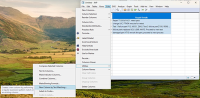

I recently discovered a JMP function/option that can handle this pretty easily.  New Column by Text Matching.
Try this script or use the utility under Cols->Utilities with your Repair Details column selected.

Thanks for sharing this function "New Column by Text Matching". It helps.
