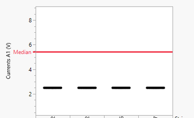

So I am trying to align the data in dt2 with the median values of Test in dt1
So The median value of Current A1 is 5.408 so subtract each rows of Current A1 in dt2 and add that back to the row values of Current A1 in dt2
5.408 - 2.4963333333 =  2.912
2.912 + 2.496333333 = 5.40. I avoiding traditional for loops bcos I have a huge dataset with 1M rows and Expr would be faster

Jackie_
Level VII
Re: Expr and Name Expr
@jthi That's correct but I want to round off  "z" to 2 decimals and then add it back to y. The reason for doing this is "offsetting the tester data with the master data"
