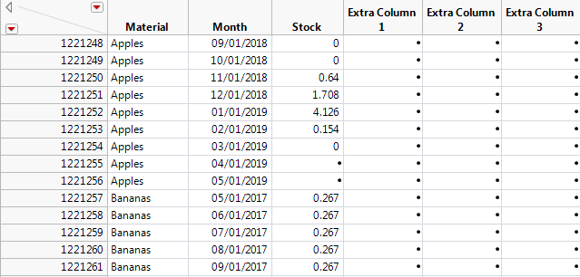

Hey everyone,
I'm new to JMP scripts and I'm hoping this may help others too.  From the sample data screenshot below (stored as a .JMP file), I'd like to select Material and Month and round Stock to a whole number.  I'd then like to filter only records where the rounded Stock calculation is greater than zero.  Finally I'd like the results to be saved as a CSV file.
Here is my initial attempt at a JSL version.  I'm pretty sure I'm not using the dt expressions correctly (likely among several other things as well)  Any help would be tremendously appreciated.
dt = Open( "$SAMPLE_DATA\My JMP Table.jmp" );
columns(
		:Material,
		:Month,
		New Column("Stock Integer", Numeric, "Continuous", Formula(Round( :Stock,0))
dt << Select Where Formula(Round( :Stock,0)) >=0
dt << save( "$Desktop\test.csv" );
Here is an SQL-like equivalent of what I'm trying to do
SELECT
	[My JMP Table].Material,
	[My JMP Table].Month,
	Round([My JMP Table].Stock,0) AS Stock_Integer
INTO
        test.csv
FROM
        [My JMP Table]
WHERE
        Round([My JMP Table].[Stock],0)>0
Thanks so much!
Re: Exporting Select Columns to CSV Filtered by Formula Column
I put this together quickly but it should work or be close.
dt1 = Open( "$SAMPLE_DATA\My JMP Table.jmp" );
For Each Row( :Stock = Round( :Stock, 0 ) );
dt1 << Select Where( :Stock >= 0 );
dt2 = dt1 << Subset( Selected Rows( 1 ), Columns( :Material, :Month, :Stock );
dt2 << Save( "$Desktop\test.csv" );
You were on the right path!
Wonderful, that worked perfectly. Thank you so much!
