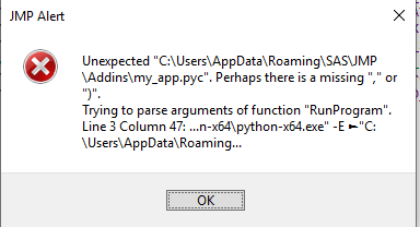

But got this error;
How can we execute cmd commands in jsl ?

i am a bit confused by what you are trying to do. However, I have attached a script written for the book JSL Companion, Applications of the JMP Scripting Language, Second Edition. For Run Program() your options need sto be specified in a list.
I hope the examples and comments provided in the attached script will help you. The error message makes sense given the syntax note excerpted from the script.
