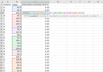

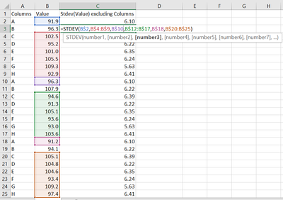

I would like to calculate the column standard deviation ,but I would like to exclude a certain rows depending another row value.
For example, in Excel, my formula in excel will be as follows, i.e the formula for each cell will calculate the standard deviation for other than the row :Columns value.
e.g this is standard deviation formula when Columns == B is excluded
e.g this is standard deviation formula when Columns == C is excluded
How can i do this in JMP using Column Formula?
