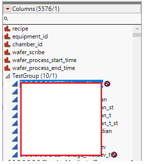

So not sure what to is going on here. I'm trying to plot this Group of cols, with several excluded. If I manually launch the FitYbyX, those excluded columns don't even show up in the pop-up and thus don't get plotted. However, when I run this script telling it to plot that Column Group, it still plots the excluded Columns. What's up with this?

The excluded attribute of a data column is intended to remove it from the column lists in launch dialogs so it cannot be selected. It is not intended to exclude it as a variable from  analysis, so when you put a column group in an analysis role, you are selecting all the columns in that group. Selecting the group over-rides the exclusion from selection.
