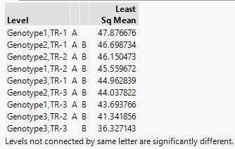

Even though it's not statistically significant, can I conduct multiple comparison test such as LSD?
I conducted 2 way ANOVA model with blocks and the each main effect was significant, but the interaction was not significan (A). However, when I checked the LSD, it shows differences among the interaction (B). When I see the plot graph (C), it seems there are some differences visiually. Therefore, I did test slices about the interaction, and I found difference about TRs within genotype 3, and also found difference about genotypes within TR-3 (D).
In this case, can I accept LSD result and say, "genotype 1 x TR-1" interaction (47.876676) is greater than "genotype 3 x TR-3" interaction (36.327143) like the LSD result (B) indicated?
My question is... even though it's not significant statistically, if LSD result provides different letter (a,b,c..), can I use the result?

This situation is not uncommon when using LSD. The LSD approach only considers the pairwise comparison error rates (each comparison is at your specified confidence level, usually 95%). LSD does NOT control the overall experimentwise error rate. So with 9 levels of your interaction, your experimentwise error rate (with LSD) is actually closer to 0.95^9 = 0.63 or 63% confidence on ALL of your conclusions.In other words, LSD may find differences that are not real. You can only be about 63% confident that the differences you found are real. For this reason most people consider only using LSD if the overall ANOVA is significant. Since your interaction was not significant, you should not use LSD on the interaction levels.
Another approach that many use is to use the Tukey-Kramer HSD method which controls the experimentwise error rate and would typically avoid this problem.

You mentioned 'to use the Tukey-Kramer HSD method' and the result is the below
If I use Tukey HSD, can I say the result from 'Genotype1 x TR-1' is greater than from 'Genotype3 x TR-3'?
Because TR-3 is an extreme treatment I imposed. Therefore, in my common sense, it seems impossible if it is said that all results from interactions are the same. Genotype1 x TR-1 is 47.876676 and Genotype3 x TR-3 is 36.327143. The difference is more than 10, and it's a huge difference in my value of experiment. So, I'm wondering if I use Tukey HSD, can I accept the difference between Genotype1 x TR-1' and 'Genotype3 x TR-3', even though the ANOVA is not significant?
Also, if that case is acceptable, could you explain why Tukey HSD is acceptable but LSD is not?
