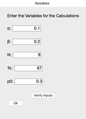

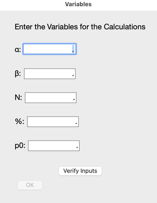

I am trying to have the user enter several variables, once those variables are deemed ok, then the ok button goes from greyed out to active.   I got this working.  What I do not have working is the Eval Expr (outputs).  This is just a simple thing just to make sure I have this working before I do the calculations. When I run the script, here is a screen shot, the OK button is greyed out:
Then I put plausible values and the ok button shows active after I click the verify inputs:
But it is not running my expression and creating the table.  What  am I doing wrong?  I am on JMP 16.0 Pro.  Like I said I did something very simple like create a table just to make sure my script is working before I do a deep dive to what I really need.

			Spacer Box(size(1, 30)),
			H List Box(Text Box("α: "), alpha_ent = Number Edit Box()),
			H List Box(Text Box("β: "), beta_ent = Number Edit Box()),
			H List Box(Text Box("N: "), N_ent = Number Edit Box()),
			H List Box(Text Box("%: "), Percent_ent = Number Edit Box()),
			H List Box(Text Box("p0: "), p0_ent = Number Edit Box()),
			H Center Box(
				Button Box("Verify Inputs", // this script runs when the button is pressed...
					alpha = alpha_ent << get;
					beta = beta_ent << get;
					N = N_ent << get;
					percent = percent_ent << get;
					p0 = p0_ent << get;
					i = 1;
					DOEN = 0;
					For(i = 1, i < 10, i++,
						If(2 ^ i == N,
							DOEN = DOEN + 1
					If(
						Abs(alpha) >= 1 | alpha == 0,
							alphaw = New Window("Error!",
								<<modal,
								Text Box("Alpha needs to be between 0 and 1, please fix and try again"),
						Abs(beta) >= 1 | beta == 0,
							betaw = New Window("Error!",
								<<modal,
								Text Box("Beta needs to be between 0 and 1, please fix and try again"),
						DOEN == 0,
							nw = New Window("Error!",
								<<modal,
								Text Box(
									"N should be 2\!U1D3A, do not include centerpoints or repeats with N, please fix and try again"
						Abs(percent) > 90 | percent == 0,
							percentw = New Window("Error!",
								<<modal,
								Text Box("The percent needs to be between 0 and 90%, please fix and try again"),
						Abs(p0) > 0.90 | p0 == 0,
							p0w = New Window("Error!",
								<<modal,
								Text Box("The p0 needs to be between 0 and 0.90, please fix and try again"),
					If(Abs(alpha) >= 1 | Abs(beta) >= 1 | DOEN == 0 | Abs(percent) > 90 | percent == 0 | Abs(p0) > 0.90 | p0 == 0 | alpha == 0 | beta == 0,
						bb << Enable(0),
						bb << Enable(1),
						write(); //not sure why this is needed here
			bb = Button Box("OK", output, << enable(0))
Show(alpha);
Show(beta);
Show(DOEN);
Show(percent);
Show(p0);
