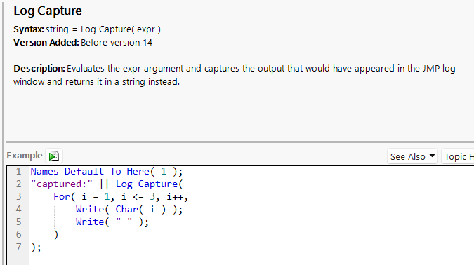

 Log Capture
according to scripting index, it captures the output to the log and returns it as a string.
but it does more than this!
It acts like try() - and allows the execution of the code to continue after a  fatal error inside the evaluated expression.
log=Log capture(
   result = zzz_missing;
   print(1)
Print(2);
Show(log)
print(1) is skipped - print(2) is executed.
almost perfect. Unfortunately (!) it forgets to write the line of code where the error occurs!
