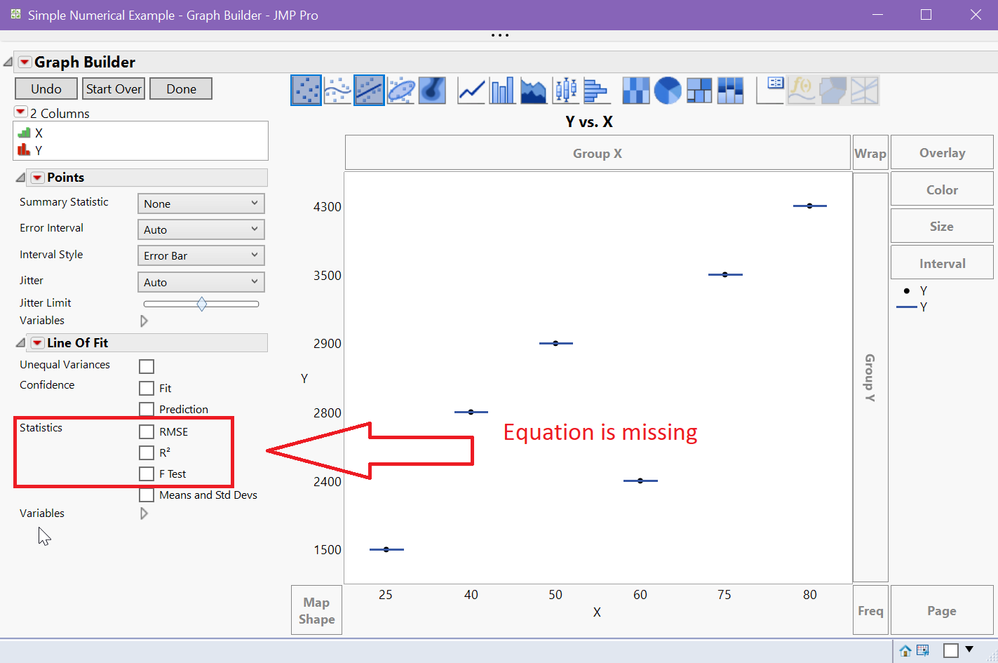

'Equation' is missing when using 'Line of Fit' graph on Graph Builder (Screenshot attached)
Hi all,
I'm trying to draw a Simple Linear Regression. I am not seeing 'equation' in the “Statistics” group (left-hand panel) on the Graph Builder. I'm using the graph named “Line of Fit.”
Am I missing anything? Any feedback would be appreciated. Thank you

Re: 'Equation' is missing when using 'Line of Fit' graph on Graph Builder (Screenshot attached)
Your X and your Y columns have categorical modeling types. Change them both to Continuous and you'll get the option you're looking for.
