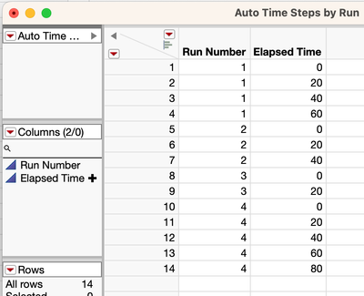

This appears to me that you want automatically make a data table like this
You can use a formula for the Elapsed Time Column like the one shown below.  It uses conditional If( ) and also the Lag( ) function to get the previous row's data from a column
example data table attached.
