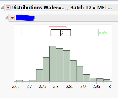

I would like to edit the title of my distribution graphs to be a bit more descriptive and easier to match up with another graph I created. I would like the title of each graph to be "Wafer = XYZ..., BatchID = ABC..."
The code I created below lets me edit the title, however, it unsurprisingly lists all the batchids that were listed in the associative array I made prior. (this array just lists all the batchIDs in a column of a table I have). What I would like to do is match the Wafer to the BatchID and display it in the title of each graph with a By statement. Is there anyway to do this? Thank you!

apparently, your version of JMP is returning a scaler when only one value is being returned.
