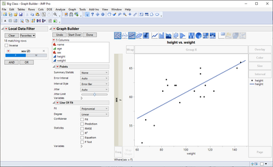

One option would be to use the local data filter also as Group X

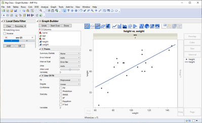

Or you can use it as Group Y and move that to left side

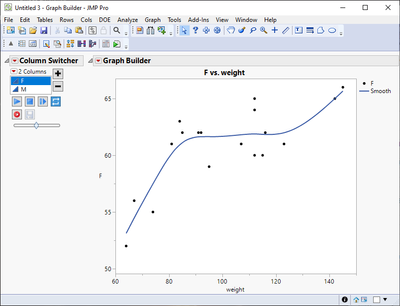

You could also split the data and use column data switcher instead of local data filter, this is most likely the best option

First split your data by Tested parameter Name and then plot it using Column Switcher
