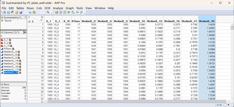

Awesome Jim thank you, I made a slight modification to pass column names 14 to end vs. any columns that weren't used for grouping. Here's the final version:

Eval(
	Eval Expr(
		Data Table( "plate_data_wide_for_dynamic_summary Anonymized" ) <<
		Summary(
			Group( Expr( GroupColNames ) ),
			Median( Expr( colnames ) ),
			Freq( "None" ),
			Weight( "None" ),
			output table name( "Summarized by PC plate_well wide" )
