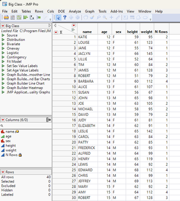

Thank you for your great help. But could you help me a little more?
how can I count duplicated "Weight" if it happens with 2 different ages or 3 as below?
txnelson
Re: Duplicate values in a colums
Assuming you want to know the count across all ages for each unique weight, here is one way to do it
names default to here(1);
dt=
// Open Data Table: Big Class.jmp
// → Data Table( "Big Class" )
Open( "$SAMPLE_DATA/Big Class.jmp" );
// Create a table that has only unique values of weight for each age
dtOne = dt << Summary(
	Group( :age, :weight ),
	Freq( "None" ),
	Weight( "None" ),
	output table name( "Summary of Big Class grouped by age, weight" )
// Create a table that has the counts of the different weights across ages
dtTwo = dtOne <<
Summary(
	Group( :weight ),
	Freq( "None" ),
	Weight( "None" ),
	output table name(
		"Summary of Summary of Big Class grouped by age, weight grouped by weight"
// Add the counts to the original data table
dt << Update(
	With(
		Data Table(dtTwo
	Match Columns( :weight = :weight )
close( dtOne, nosave );
close( dtTwo, nosave );
Jim

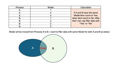

thank you so much but it's a little different with my target. My homework is like that below. But so far, I don't have ideal how to deal with that
txnelson
Use
     Tables=>Subset
with the By option based on Process
Then use
     Tables=>Join
To join matching on Model and you can select the Inner Join as you indicate
Jim
