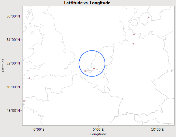

I'm plotting several port cities on a map as part of an simple application I'm building.
Next step I want to take is to draw circles on the map indicating a user-defined distance from the city defined by a value in the data-table which is modified via scripting. Simple example: plot the location of port of Rotterdam on a map, and draw a 10 nm circle around this location on the map.

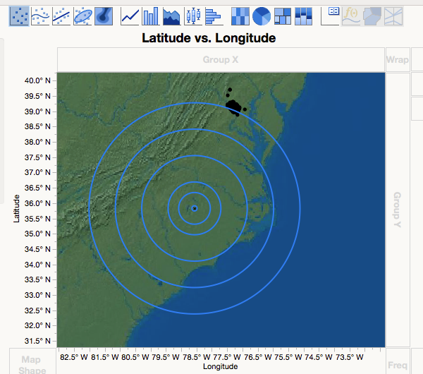

As chance would have it, I've done this... The attached script should give you some clues as to how to approach the problem.  change the centX and centY variables to the coordinates of your location.  You can find these using google maps, right-clicking on the location and selecting "what is here?".

Thank you both; I ended up using the 2nd solution. I did a brief cross-check to sort out the conversion of miles to degrees based on a known distance between two locations and the results match.
