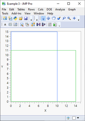

Graph Box with Rect is one option if you just want to see the rectangles
Names Default To Here(1);
nw = New Window("Example",
	gb = Graph Box(
		Frame Size(300, 300),
		Pen Size(1);
		Pen Color("Blue");
		Rect(0, 15, 10, 0);
		Pen Color("Green");
		Rect(0, 11, 14, 0);
nw[AxisBox(1)] << Min(-0.1) << Max(15.1) << Inc(1);
nw[AxisBox(2)] << Min(-0.1) << Max(1.1) << Inc(1);
-Jarmo

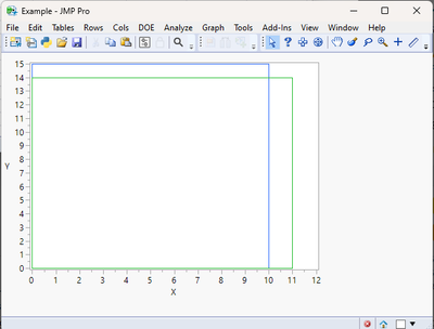

Here is a simple expansion on Jarmo's example.  I simply moved away from hardcoding the values, to using the data table values directly.
Names Default To Here( 1 );
dt = New Table( "Example",
	Add Rows( 4 ),
	New Column( "ID", Character, "Nominal", Set Values( {"1", "1", "2", "2"} ) ),
	New Column( "Parameter",
		Character,
		"Nominal",
		Set Values( {"X size", "Y size", "X size", "Y size"} )
	New Column( "Value",
		Numeric,
		"Continuous",
		Format( "Best", 12 ),
		Set Values( [10, 15, 11, 14] )
nw = New Window( "Example",
	gb = Graph Box(
		Frame Size( 300, 300 ),
		Pen Size( 1 );
		Pen Color( "Blue" );
		Rect( 0, dt:value[2], dt:value[1], 0 );
		Pen Color( "Green" );
		Rect( 0, dt:value[4], dt:value[3], 0 );
nw[AxisBox( 1 )] << Min( -0.1 ) << Max( 15.1 ) << Inc( 1 );
nw[AxisBox( 2 )] << Min( -0.1 ) << Max( 12.1 ) << Inc( 1 );
Jim
Zack94
Level I
Re: Draw a rectangle but X and Y are in the same column
Thank you very much; I adapted the script to my table and it works.
