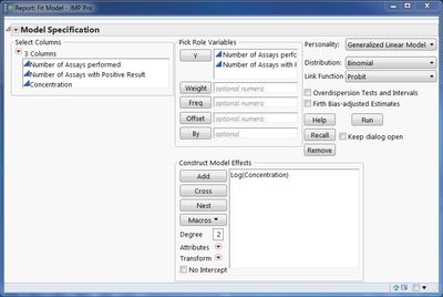

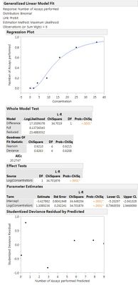

Dave,
Your "number of assays with positive result" needs to go in as a "Y" variable also. The Frequency role is for indicating how many times a row in the data table actually occurred. In this case, the GLM model expects the number of assays performed and the number of positive results as "separate" Y values. The analysis will link them together.
One thing you did not mention that is often done for this type of work is to take the log of the concentration. I did this in the model dialog shown above. Highlight the concentration model effect, click the transform button and choose log. Results are posted here.

Re: Dose Response Probit analysis
Dave,

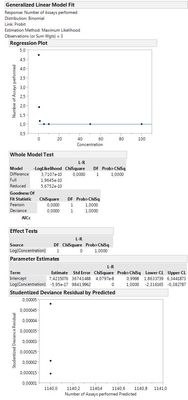

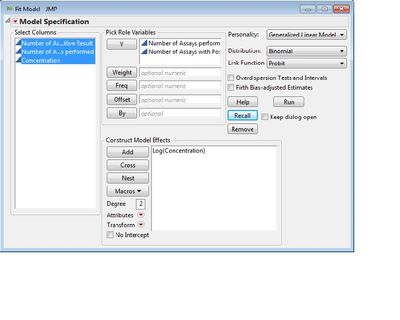

sorry for bothering you again, but changing the numbers to the demo, I seem to be getting wrong results. Please have a look at this dataset, with same variables but different numbers. For the three highest concentrations I get 100% positives

I run the Probit as you suggested
An after running I get a strange result which doesn't make sense to me. Instead of doing percentages of corrects on the Y, it seems to be doing something different. What am I doing wrong?
Thanks ever so much for your help
Dave
Been following this thread with interest.
From the JMP docs:
If your data is summarized as frequencies of events and trials, specify two continuous
columns in this order: a count of the number of successes, and a count of the number of
trials. Alternatively, you can specify the number of failures instead of successes.
(my emphasis).
So if you switch the order the 2 y variables are entered I think you will see more of what you expected especially if you change the x axis to be logarithmic.
That said, I can't explain why the order doesn't seem to matter with your original data.
Michael
mpb
mpb
Level VII
The 0 10 0 last row from the original data for some reason insulates the analysis from needing the correct order. If you leave it out then order does matter.
Michael
That is indeed the right order to feed in the variables. Thanks for pointing that out, Michael.
