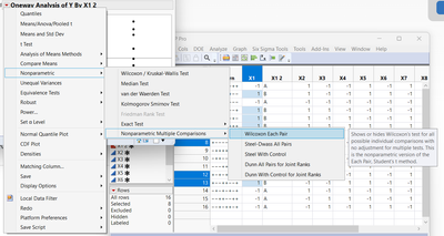

Hi @MarkovRank1093,
If you hover your mouse on the test, you can have a short description of the test and see if it adjusts for multiple testing :
You can also check the JMP Help related to the use of nonparametric tests : Nonparametric Multiple Comparisons Reports
If you're looking for a nonparametric test with multiple testing adjustment, you can perhaps use Steel-Dwass All Pairs test, which is the nonparametric test version of the Tukey-Kramer test.
