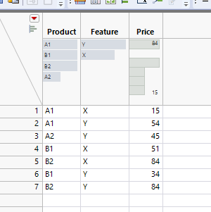

I have been mystified by the Split-platform (Table -> Split). I think that with some conditions, splitting does not work correctly. I provide a simplified example here. Lets assume that I have a following table (also file attached):

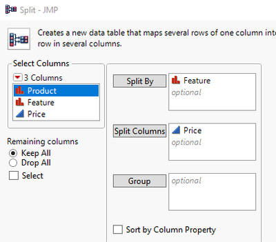

If I open now the Split-platform (Table -> Split) and give inputs as follow:
I would expect to get following outcome:
But I am getting the following output:
If one looks the realized output table more carefully, one can see that values originally mapped for Product A  gets mapped to Product B. This is wrong. This happens if there are non-equal amount of rows per feature to be split. With larger datasets, this is very difficult to notice and can lead to very wrong conclusions.
Can somebody confirm this so that I not alone with these thoughts?

In your example, you did not specify the Grouping variable, resulting in the odd behavior you observed. Use Product as your Group variable for accurate split.

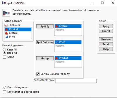

Thanks for your suggestion. However, no matter what I use as Grouping variable, I don't get the result what I would like to have (below):
If you think that grouping is the key, you need to give more detailed step by step instructions.
thanks;
Janne

The first proposal by Thierry_S to use grouping variable would be intuitive. I am sad to see what grouping does; just last data rows per group get in and all other data rows get vanished (see captures below (Unless each row used for grouping is unique as Jarmo suggested)). Generally, when I do split, most certainly my intent is not to vanish the data and thus not very happy for need to have special tricks to avoid this. Maybe there is some logic which is just beyond of my understanding
