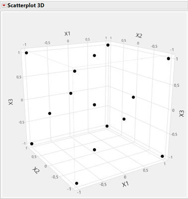

And in 3D the repartition of points look similar to a Central Composite Design (which would need 26 runs for 4 continuous factors) when you specify axial value of 1 (axial points "on face") :
