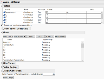

You can do this very easily by using the platform Augment Designs.
One your factors and responses have been specified, you can change the ranges of your factors to reduce (or augment) the ranges of your factors, before choosing the augmentation strategy :

I think augmenting the design is still a better idea than starting again from scratch, as some prior information about influence of factors can be leveraged and help reduce the required number of experiments.
When augmenting, you can check "Group new runs into separate blocks". I really recommend checking this option as a safeguard measure, as it helps you take into account and mitigate risks of having shifts or difference of variance for your responses between the initial set of experiments and the augmented one.
Then, if you want to add blocks in your augmented design, it may be possible but not straightforward :
  1. Augment the design with the total number of runs expected (a multiple of 3, in the example recreated here, I started from a 34 runs I-optimal RSM design, and I add 12 runs thanks to augment design platform) :

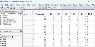

  2. On your datatable, create a table with only your augmented runs with the option Create a Subset Data Table :
  3. Using the platform Custom Design on your subset table, use the option "Select Covariate Factors" to enter your factors from the subset table (but not the Block factor if you have checked the option "Group new runs into separate blocks" as the only value will be 2 and you'll be rearranging these augmented runs into random blocks of 3 runs). The augmented runs will be used as a Candidate set. You can then add a blocking factor (3 runs per block) in your factors list :
    You can also check the option "Include all selected covariate rows in the design" to make sure the augmented runs created previously are all considered and used. This step is only used to re-arrange the order of your augmented runs into random blocks respecting your experimental constraints.
  4. You can then change the Design Role property of the blocking factor to "Random Block" if needed (you can also change it when setting the model for analysis in the Fit Least Squares platform using Attributes options) and copy paste the design with the augmented runs from the custom design (with the order from the random block effect) to your original complete augmented design datatable to replace the order of the augmented runs :
