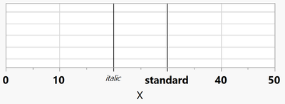

A colleague found a nice example which shows a similar bug caused by a conflict of different settings in Graph Builder:
A user is not allowed to define a setting to be STANDARD  if on a higher level a non-standard setting is applied.
In Graph Builder, there is a control for the axis settings - and within the axis settings there is a control for the reference lines.
The reference lines seem to inherit the font settings from the axis settings.
And the only way to "delete" an inherited setting is: apply a non-standard setting and thereby overwrite the inherited setting.
Difficult to explain - but easy to "experience":
The text of the label  "standard" should be "standard", not Bold - run the code and try your luck:
dt = new table("test", new column ("X"));
Graph Builder(
	Size( 469, 260 ),
	Graph Spacing( 4 ),
	Variables( X( :X ) ),
	Elements( Points( X, Legend( 2 ) ) ),
	SendToReport(
		Dispatch( {}, {:X}, ScaleBox,
			{Min( 0 ), Max( 50 ), Inc( 10 ), Minor Ticks( 1 ),
			Add Ref Line(
				20,
				"Solid",
				"Black",
				"italic",
				1,
				1,
				Label Settings( {Set Font Style( "Italic" )} )
			), Add Ref Line( 30, "Solid", "Black", "standard", 1 ),
			Label Row( Set Font Style( "Bold" ) )}
A similar issue arises with preferences and custom settings. Once a setting in the preferences differs from the standard setting, the user is forced to use this setting. There is little chance of forcing a report to use the standard settings, especially after the report has been changed and the script saved. This is the time where "reset to standard" gets lost.
Even worse with reference lines: no chance to reset the setting at all?
