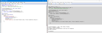

I'm trying to create an continuous distribution using the column list store in "collist"
it show below error and the distribution did not come out.
Names Default To Here( 1 );
dt=Open( "C:\2023 Project\Try.jmp" );
//dt = Open( "$SAMPLE_DATA/Blood Pressure.jmp" );
ListofColumnNames2= dt << get column names();
show(ListofColumnNames2);
collist = {};
For( i=3, i <= N Items(ListofColumnNames2), i++,
	Insert Into( collist, ListofColumnNames2[i] );
show(collist);
dist = dt << Distribution(
	Stack( 1 ),
	Continuous Distribution(
		Column( evallist(collist) ),
		Horizontal Layout( 1 ),
		Vertical( 0 ),
		Process Capability( Use Column Property Specs, Process Capability Analysis )

You might have to move the column list outside the Continuous Distribution
Names Default To Here(1);
ListofColumnNames2 = dt << get column names(Continuous, "String");
collist = ListofColumnNames2[3::N Items(ListofColumnNames2)];
	Stack(1),
	Column(Eval(collist)),
Scripting Index also provides example like this

Thank @jthi. Its work. Appreciate your help :)
